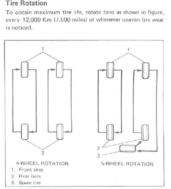

LOL NO DUDE
front left to rear left
front right to rear right
Tires have a tread and it needs to go in one direction - if you swap left and right then your tires are the wrong way around!! :erm:
(unless of course, you take the tyres off the rim completely :D)
DUDE if you read right you'll realise its the same...moral of the long story, rear tyres go to the front and vice versa...same thing mate!
or no...you're right...left rear to right front...right rear to left front...thus it still keep same rotation pattern...shot dude!
yes, but only if you strip the tires off completely and put them on the other rims - if you're plain just rotating tyres ALONG with the rims, aka, the easy way, you should not let left & right wheels cross
I edited the post...just check my last one before this..you're right
no it won't, if left and right cross your wheels will be rotating backwards
so right right and left left...lol I'm confused now...don't even know where my rifht middle finger is now!
there we go.
yeah the way you rotate is:
Right front to right rear
left front to left rear
The reason they will "last" longer is because either you car is front wheel driven or rear wheel driven or all wheel drive with a bias to the rear. So wheels that provide the drive will tend to wear out faster then the other wheels.
So when you rotate, you ensure they wear out equally.
