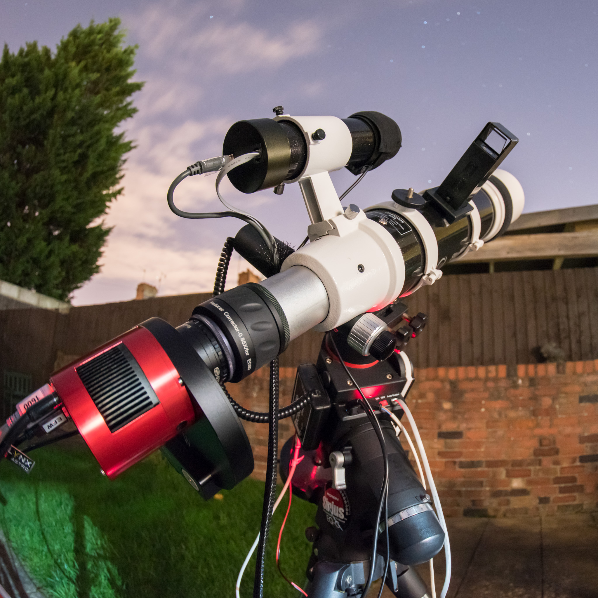

I specifically want to get into the AP side of things but damn - it's sooooo expensive
Depends where you start.
They have some really fantastic entry level mounts nowadays:
Sky Watcher Star Adventurer GTI
That plus any old DSLR and a normal lens get you started in a really nice place.
Well let's put it this way. I added everything I want to cart on first light optics and it came to 7000 pounds :crying:
I'm more interested in getting a proper mono camera with filters and that's where the problem just escalates
Don't write off a OSC camera by any means...
