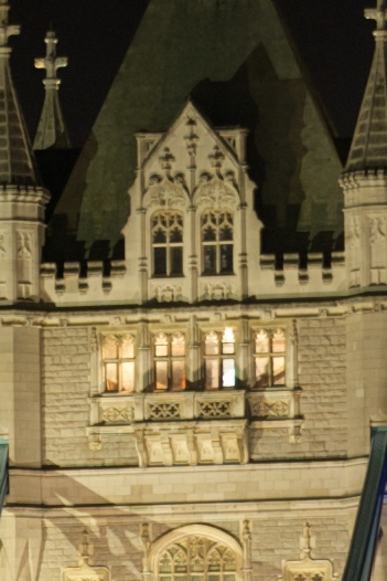

One day I'll go back to some of the places I took pictures of with a 6 MP DSLR, and take those same pictures with my fairly expensive 8MP P&S and post them here for comparison.
OK, I went back and shot one of my shots again with my fairly expensive P&S. I tried to get the images as close to one another as I could with respect to the field of view, but unfortunately it seems the P&S's live view lies a little. Anyway, I set it in program mode, and ISO200 (because that what the DSLR shot was on), metering to center, focusing to center, NR on, face detect, red-eye reduction and all other gimmicks which might confuse the camera in this situation are switch off.
Here's a 100% crop from the P&S, Noise reduction on, ISO200, f/3.5, 1/1.5 second shutter, 12mm:
Now here's more or less the same 100% crop from the 6MP DSLR, Noise Reduction on, ISO200, f/8, 4s shutter, 55mm:
BTW, this particular P&S cost more new than the DSLR did. Both were end-of-line at the time.
I rest my case...

Agreed, but the blotches you see in my 8MP P&S shot are not due to the lens (it's a Zeiss lens, by the way), but a combination of noise, poor image processing and too lossy jpeg compression.
Incidentally, when I played with the Canon G9, the jpegs wasn't much better, but RAW was much sharper and in Aperture I was able to produce results much closer to what I expect from a DSLR.
One more piece of the puzzle, aside from the lens, and the size of the sensor, is the image processor. It never ceases to amaze me that my Canon 40D can spit out a very high quality jpeg image much much faster than my dual core 2GHz MacBook can.
I agree that you get what you pay for, but I'll add to that that what you get doesn't necessarily justify the money you spent. High end point&shoots are disproportionally expensive. Many of them are more expensive than entry level DSLRs, yet the results they produce are not as good. OK, for shots taken in good light, the differences may be harder to tell, but in anything other than perfect conditions, it's very apparent.
When I get my G9, I'll do some more comparative tests - I'll have a high end P&S of higher MP than my DSLR, from the same manufacturer, using the same image processor (Digic III). Should be interesting...
Thanks HavocXphere. I should add that the DSLR's colour is only correct because I set the white-balance manually. There are too many light sources - I don't think any camera will get it right there. But even so, the P&S shot, despite the camera liberally boosting contrast, looks washed out by comparison.
