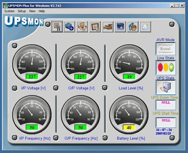

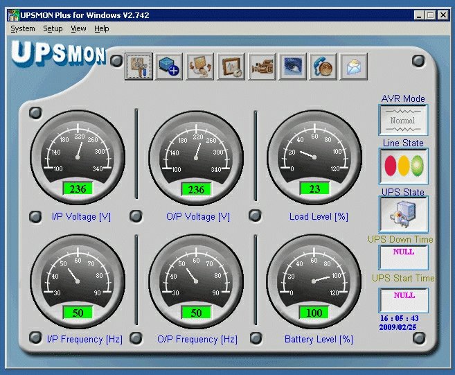

UPS Software installed...
UPS 1
UPS 2
I took these after I installed the UPS software.
If anything, I'd give a guess at, they are almost a year old.
