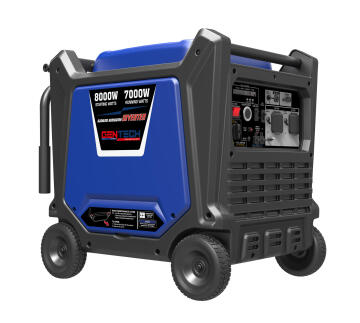

Hiya guys looking for a genie
Portable around 7kva
It needs to be able to run a few hair dryers and a few other things for my chicks work.
So portable petrol or diesel.
Decent quality
Need input please guys.
Looking on takealot as I have a lot fo ebucks
Thanks

Can you give us a breakdown of what appliances need to be run and for what period of time? For example - a hairdryer runs at between 2500w and 3000w for around 5 to 15 minutes depending on length of hair... what other things need to be run and at what wattage?

Specifically hair dryers running for maybe 30 min ar a time.
Not more than 1 at a time.
Maybe some TVs at times ?

Which one is it ? I'm looking at a 7kva unit maybe 3000 watts I think?

You gotta check the different model ie most tend to run most economical in the mid rev range (salt generalisation)
It depends how many hair dryers you want to run at the same time
Ie this one is 7.5kva /6800w
The bigger ones tend to have bigger motors so would cost more per hour
But naturally you don't want to run a generator at max or on idle
Unless you go for inverter generators:
They tend to ramp up as your consumption increases.

7kva is not 3000 watts, this is a 6.5kva which is 5kw and is the one that I own. Ran Edit: Can run fridges/tvs/desktops with no issue:
