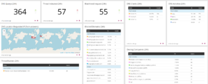

Finally finished my setup.Not to derail the Rpi thread, but where did you get a Rock64?

One of my pi`s is similar. Run diet-pi on it with wifi-ap, borgbackup and webmin (it gives nice traffic usage stats for each host on the AP)Finally finished my setup.
https://medium.com/@fbotes2/secure-dns-ids-and-wifi-ap-using-arm64-rock64-a0faa85bd833
Went a bit different using Snort, Pi-Hole, Graylog and setting up Wifi-AP from the device. Fun little project.
Must say I'm very happy with the performance.One of my pi`s is similar. Run diet-pi on it with wifi-ap, borgbackup and webmin (it gives nice traffic usage stats for each host on the AP)
Yeah so am I, but I only have my devices on it, so it does not have much load. After reading so many people who didnt think it was quick enough to be used for this purpose... Im happy.Must say I'm very happy with the performance.
What guide did you use to set this up?
Updated the post to include the guide. Also created a content pack to do the whole DNS dash.What guide did you use to set this up?
Thats very helpful, thank you.Updated the post to include the guide. Also created a content pack to do the whole DNS dash.
Rest I did following: http://docs.graylog.org/en/2.5/pages/dashboards.html#widget-types
What kind of throughput do you get ?I have 3x pi, only really using the 1.
Currently have it with a Diet-Pi install, theres an option to setup your pi as an AP.
My ETH0 is internet and WLAN0 is LAN. Installed webmin and shorewall firewall, so its more than just an AP. It does DNS masq, firewalling and is my own little AP network. Wondering if I could put a pi hole and greylog on top of it.
I would guess its as fast as my wireless. My network is not ideal to test that on. I go through three AP relays to get to a wifi router thats connected to a wifi wan. Its only 4mb internet. There is no real load on the system though and nothing feels laggy.What kind of throughput do you get ?
Pleasure, I'm testing Grafana as an interface as well and will publish the data parser when completed.
Also looking at doing vulnerability scans using openvas on devices then working results into the dashboard.
