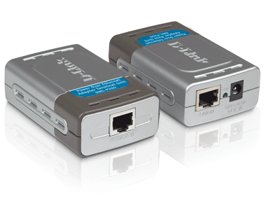

Basically, 10-base and 100-base networking uses pairs 1,2 and 3,6 for transmit and receive. Pairs 4,5 and 7,8 is unused.
PoE "injects" positive power on 4,5 and negative on 7,8
You get PoE injectors and PoE splitters. Then injector is a specially designed block which prevents power leaking back to the normal network, whilst a PoE splitter "splits" the power from the network cable so that you can plug it into the device which doesn't support PoE.
Google PoE injector and PoE splitter for more information ;)
Keep in mind that, for long cable runs, you might need to increase the voltage at the input end to compensate for voltage drop so that you get the correct voltage at the other end.
Any chance of posting some links to the actual products used to set up a network like this?
http://www.dlink.com/products/?pid=DWL-P200
READING THE QUESTION
He is asking about ethernet over power not power over ethernet lol
