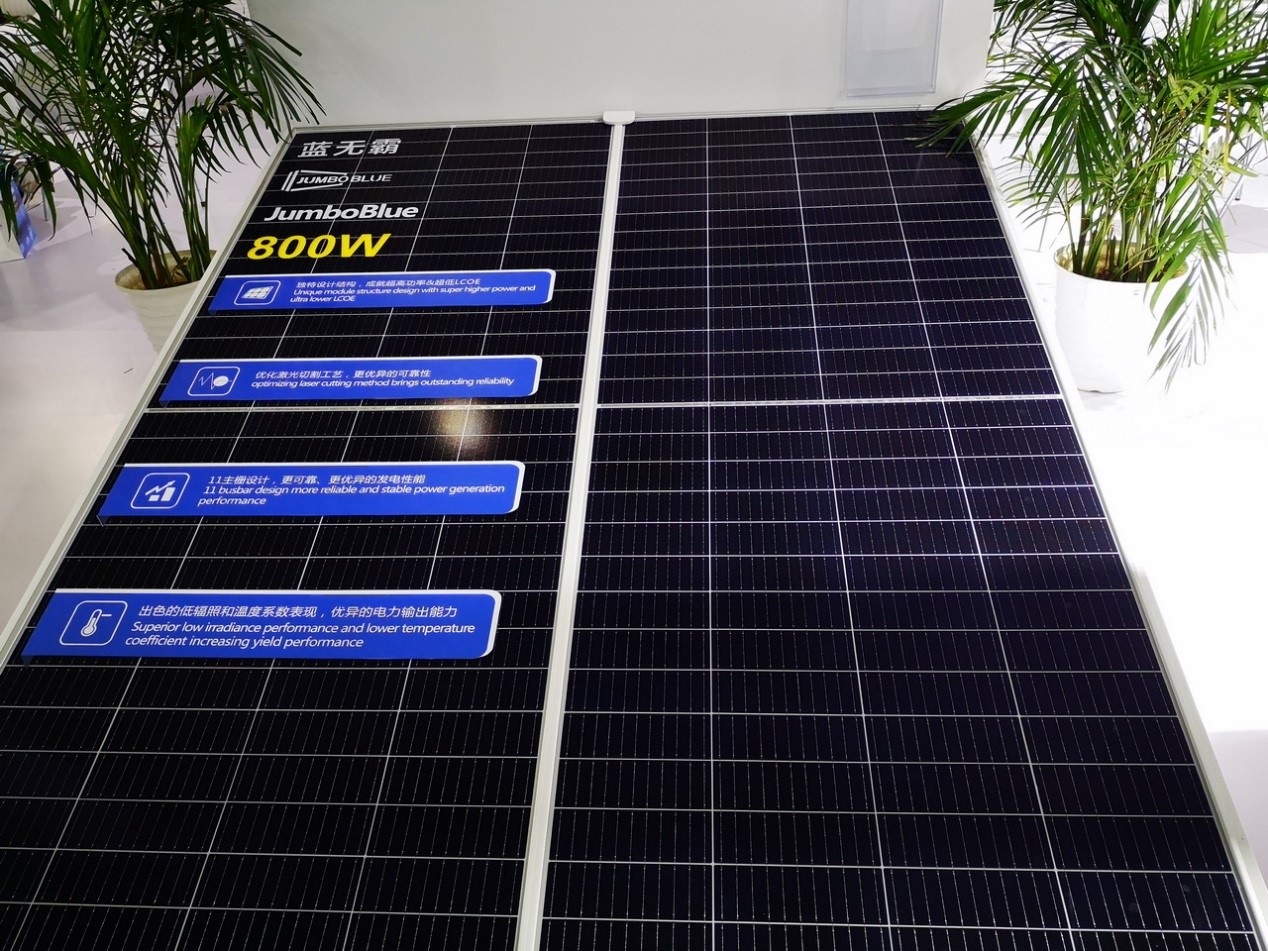

1000w solar panel? Is it even true
Nothing stopping them from making 1000W solar panels BUT they would probably be 3M by 2M .
800w is 2.2 x 1.7 so not quite :)
Would be closer to 2 x 2.3M for an 1KW panel
