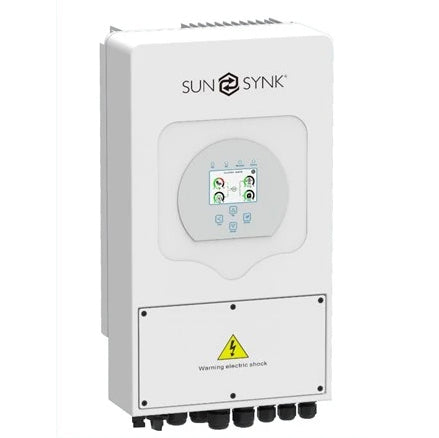

What is the key benefits of the Sunsynk Invertors over the others. As there is a significant price difference?
  • Flexibility
    • Super Hybrid: Grid and Aux ports are both inputs and outputs, and both have shaving abilities and exterbnal CT coil capabilities;
      • Ability to export up to the external CT coil. You can get away with a smaller inverter because of this , for eg. you can use excess solar to power non-essential loads like oven and water heating;
    • You can safely export to grid (if it makes sense for you);
    • You can schedule and service loads like pool pump through the Smart load on the Aux:
      • If batteries are full and there is excess solar you can pump the excess Watts into your geyser;
    • You can add another cheap solar only or micro inverter/s to the Aux port;
    • Ability to take a genny (Aux as well as grid side);
    • Ability to configure the MPPT to control a wind turbine;
    • All above are "out of the box", no additional components needed.
  • Expandability
    • Single phase models range from 3.6-16kW
      • 3x single phase inverters can be deployed in a 3 phase combination
    • Pure 3 phase model available in 12kW
    • All models can parallel. Up to three in single phase and nine in 3 phase
  • 5 year warranty: Well-designed with quality components
    • Ability to "punch above its weight"
    • I have a picture of a 5K Sunsynk producing 7.79kW, exporting 6.29kW to the grid and servicing home loads of 1.22kW simultaneously, and sustained (not just for a minute or two);
  • Manufacturer's local commitment: Sunsynk is totally committed to SA
    • Sales and aftersales support: Showroom with a free installer training lab in Randburg;
    • 4 major local distributors (Segen, Heroldts, Ellies and Getoffgrid) plus a few minor ones
      • Many have their own repair centres
      • Great local support in all major centres
    • Excellent responsive remote tech support for installers via Whatsapp
  • Battery manufacturer support (with CAN, Serial and RS-485 comms, the listing is over 3 pages);
  • Easy timer-based programmability, can be operated by a layperson;
  • Choice of Solarman or Sunsynk dongles, the latter supporting cabled ethernet and GSM in addition to Wifi
  • OTA firmware / OS updates
  • Ability to "fire and forget" (no unnecessary fiddling, tweaking and constantly demanding attention like Axpert-types);
  • Easy to install, and many approved installers;
  • Champagne on a beer budget (Victron-like performance and flexibility at 1/2 of a Victron's price)

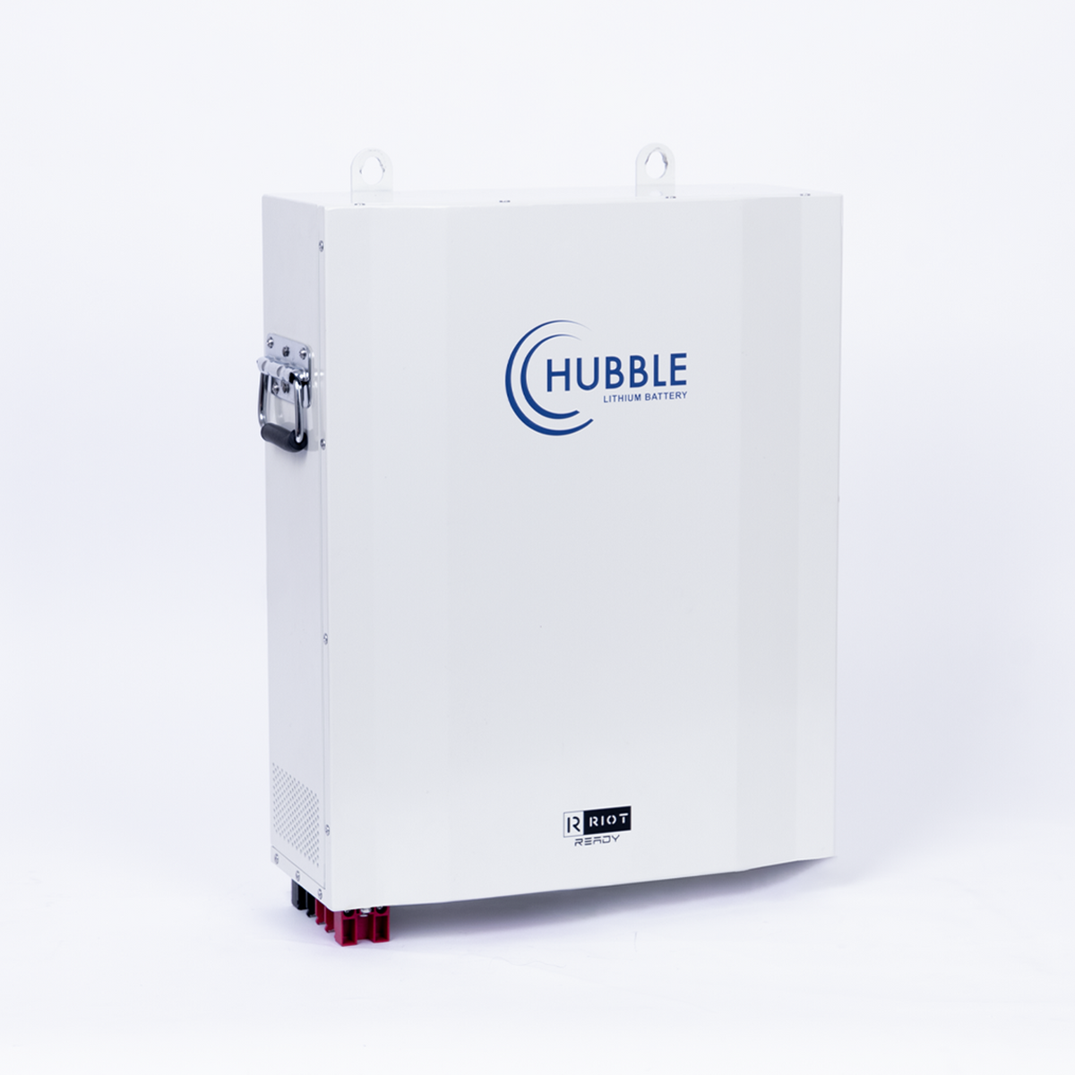

Batteries, why would you choose one hubble battery over the other? Pylon?
A huge topic. Sunsynk supports almost everything out there, you can pick and choose. I have older Pylontechs in my own home, but prefer Hubble, and last week did a recent install for a family member consisting of 3 Hubble AM-2 and a 5.5K Sunsynk. 6.4K panels will be installed in the coming week.
My own preference is based on:
  • Quality cells: Am-2s use first life BYD cells. BYD, CATL are amongst the largest lithium battery manufacturers in the world
  • Local support: Hubble are based in SA, and have service centres in most large cities
  • Good warranty: 10 years on the AM-2, and not as prescriptive as other manufacturers
  • Great proven BMS
  • Cloudlink.
    • Hubble recently purchased an integrator called RIOT whose little box of tricks allows some deeper inspection of the Hubble batteries, and
    • Remote login and support from Hubble.
      • This means that if something goes wrong, I don't have to travel 1000kms, uninstall and lug them (around 45kgs each) to the nearest service centre. The techs can log in remotely and do diagnostics.
    • OTA firmware updates (coming soon for batteries too)
    • I was checking out the Cloudlink this week, it's only installed via the serial port currently (I had a cable crisis), but also uses the CAN and RS-485 ports when properly installed.
      • Even in beta version for the 5K Sunsynk it allows access to an astonishing amount of info, including the ability to override BMS values.
      • Lots of forthcoming attractions in this little box including home automation integration. Supports 8K Sunsynk today and 5K support will be added in the next few weeks
  • Wall mount: Far better than an obtrusive cabinet or standing on the floor, they look neat.
  • Chemistry: Hubbles are NMC vs most other lithium-ion derivatives. Smaller form factor (more energy dense) and far greater charge / discharge rates (1 Coulomb)
    • which means that one AM-2 can charge and discharge at 100A;
    • So less batteries needed to provide 5000 watts of 220V AC electricity; and
    • Less wear on the batteries when multiple are installed in parallel (charging and discharging at 0.5 or 0.3C extends their life)

  • Flexibility
  • Expandability
  • Great proven BMS
  • Cloudlink.
