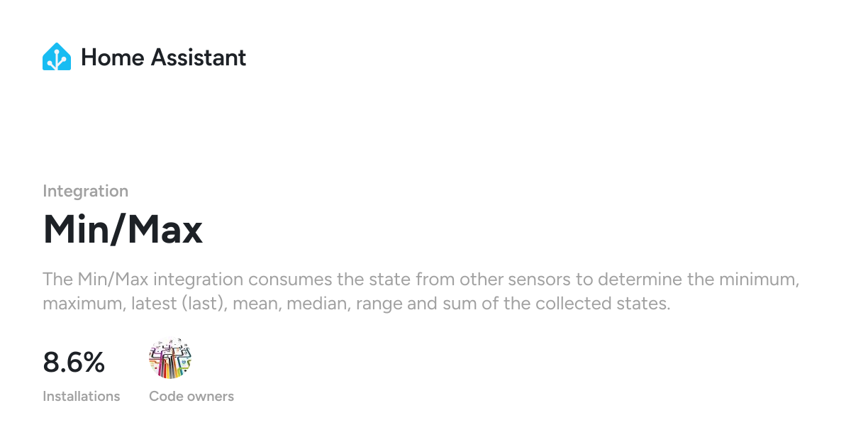

I'm trying to figure out how to create a sensor that tracks the MAX difference between the two extremes of four batteries.
EDIT: Should have googled before trying to do it in a template:
EDIT2: Right - now lets see what happens :D
