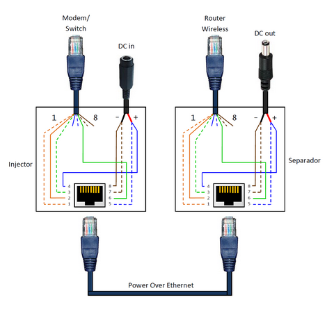

You will definitely fry the device if one of the LAN ports doesn't support PoE injection.
If you're not capable of DIY and connect power to ethernet, you should clearly not DIY. Just split ethernet and power on both sides and run ethernet on 2 pairs and power on the other two.

If you're not capable of DIY and connect power to ethernet, you should clearly not DIY. Just split ethernet and power on both sides and run ethernet on 2 paris and power on the other two.

It's really simple in theory - only two pairs of the ethernet cable are used for network, the other two can be used for power. Very important that you don't reverse the polarity on the power (i.e. it comes out the other end the same way it came in).

All well and good on a Fast Ethernet (100Mbps, 2-pair) installation.
Just don't try it on a Gigabit ethernet link!
3G/4G routers don't have Gigabit Ethernet. Besides there is a way to do it (properly) on Gigabit Ethernet.
Bit of a broad statement, that.
We may not have seen any yet, but on LTE devices Category 4 (150Mbps) and up, they should start to appear.
Of course. "Proper" PoE has already mentioned (there are in fact two Gigabit PoE modes).
What's been shown here is a DIY version that will work fine on Fast Ethernet only.
