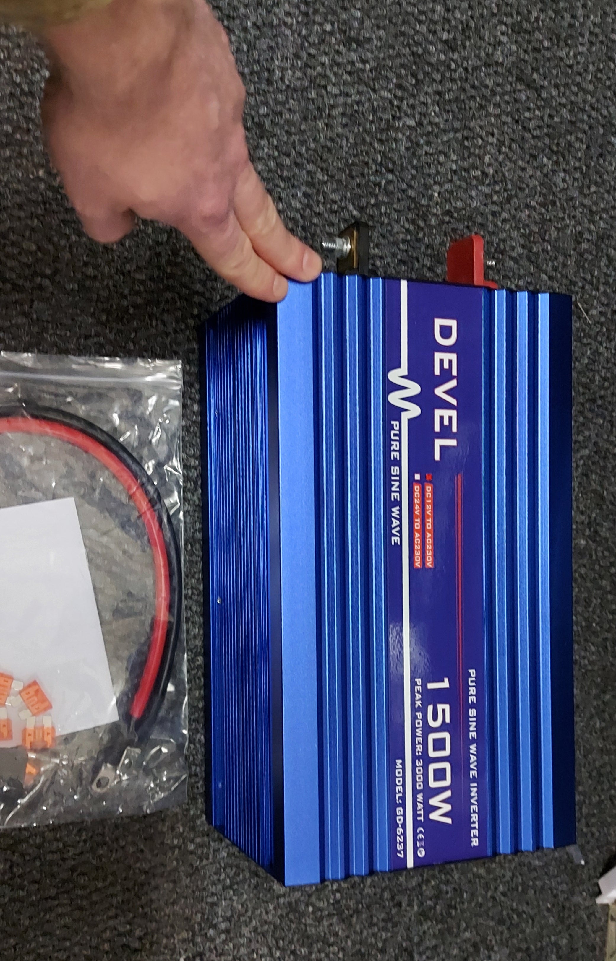

And then I need to pair that battery with a 12V 1500w-2000W inverter, and this is where I need recommendations please.
I was looking at these options.
Anyone with previous experience of these inverter brands?

You are limited to 100A with a 12V LFP battery. So 12V x 100A = 1200W max.
15A charger will take 200/15 = 13 hours to charge.
The dataspec does mention 400ah peak discharge, but thats probably only for a few seconds.
Atleast it is possible to exceed 100ah discharge even if its only for a few seconds.
His little brother also has a discharge of 100ah. Should I rather think about two of these in parallel, will that double the available discharge I have available?

Then I have to look at 24V inverter or bigger. And that means more or bigger batteries.
Very few 12V inverters includes a charger for an affordable price, except victron and a few others.
But yes, a good charger is probably another R3k

With a Caravan system. Good and reliable brands is a must as mentioned in the previous posts. You dont want to go cheap on this and have a failure or worse, Caravan crying in flames.
Get someone that has good knowledge on installing the system so they can have it DC to DC coupled with your alternator so while you are driving, the battery can still be charged even if there is no sunlight.
I think this is going to be my build.
Phase 1
This inverter boosts 70A max recharge, UPS and most importantly reliability.
Phase 2 will be a solar charger and 2 panels for that off the grid places
