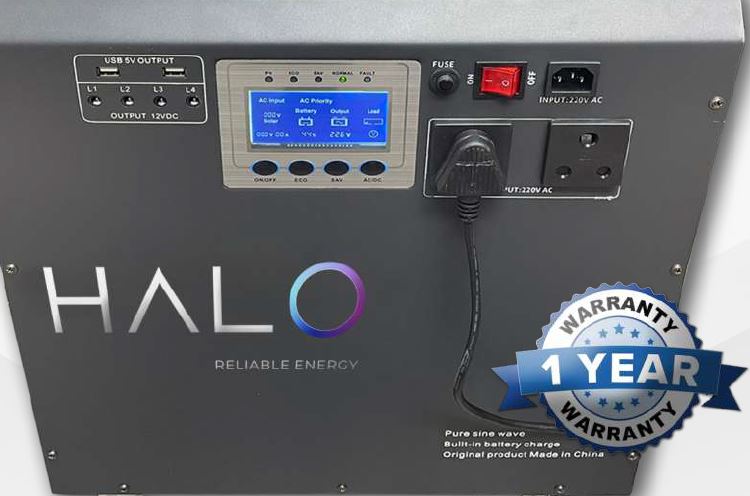

Could you kindly recommend a load shedding solution for a gaming pc (650W-700W peak draw)?
Those okes at powersolutions.co.za are smoking ganja...R17k for a 1000W setup.
Not sure if this includes battery but should cover you for 2 hours:
