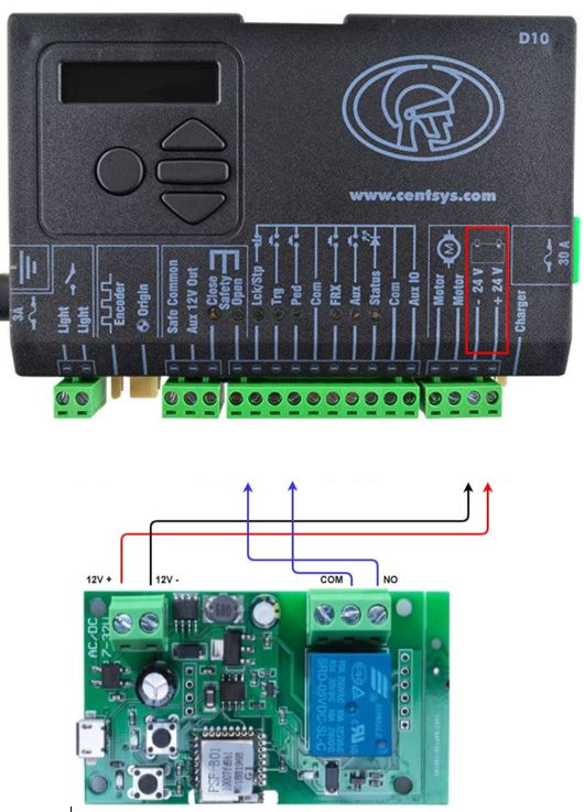

Hi guys,
I have Centurion D5 EVO motor.. I connected an Ewelink SV INCHING /SELF-LOCKING WIFI WIRELESS SWITCH 5V 24V module.
Problem 1, when connected then remote and intercom doesn't work. However it opens the gate a quarter way and have to press button on phone multiple times to close.
See Pic of how I connected.
I would like it to work like the kughts, when eWelink shows on then gate is open and when eWelink shows off gate is closed.

What does the wiring on the Sonoff side look like ?
Had a quick google and came across this. Seems straight forward. Don't forget those inching settings
