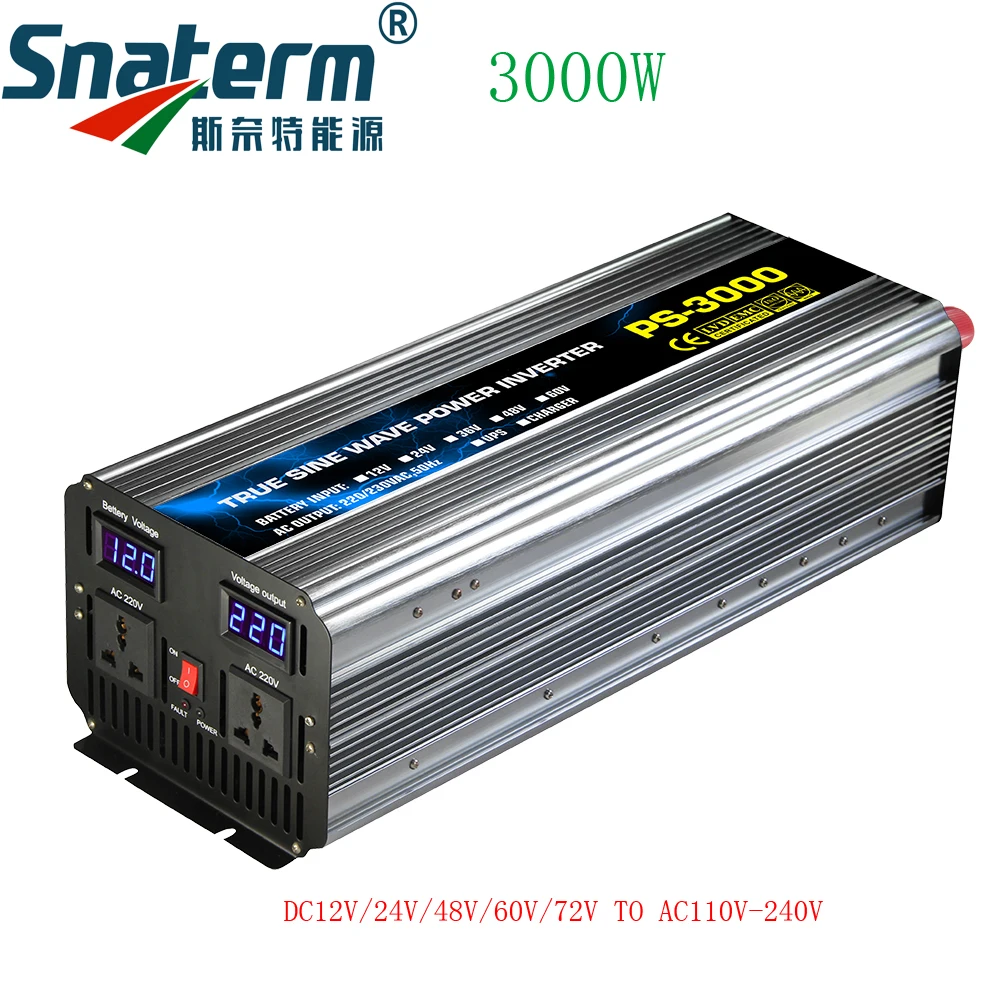

~R5.5k with shipping and import taxes for 24V and 3kW continuous load (so it can run a kettle)
You need the inverter to be pure sine so it plays nicely with desktop PSUs
You'll also want the EPS model so it behaves like a UPS
This looks good. But... it's still an old lead-acid charger design so who knows if it handles the long high-current phase for lithiums without melting.
