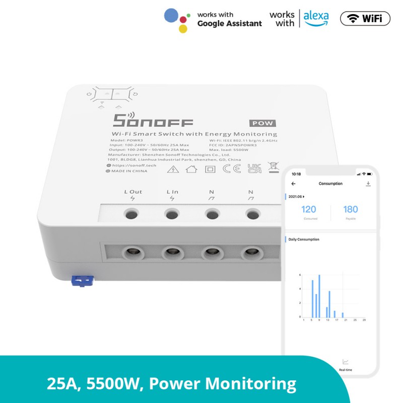

I just installed this SONOFF and I can monitor my geyser anywhere in the world
I can also monitor my daily and monthly usage and costing
Sonoff POW R3 25A WiFi Geyser Smart Switch with Power Consumption  Measurement (compatible with Google Home/Alexa) - High Power 5500W - GeeWiz
