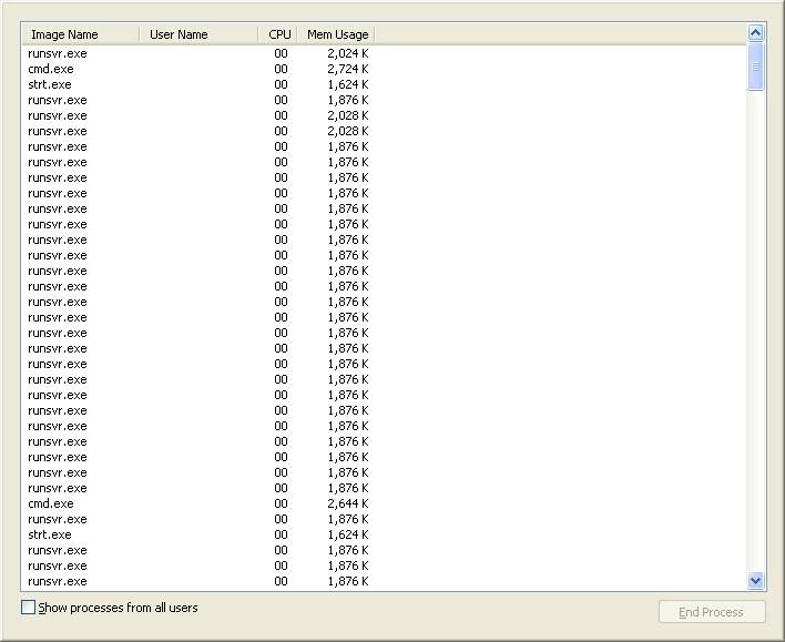

I think it must be local, as a quick search for the offending files runsvr.exe and OSDSP.exe reveals nothing. And none of the major anti-virus programs pick the thing up.
It fills up your task manager and brings your system to a grinding halt.

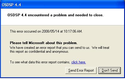

And bombs itself out half the time with it's stupid OSDSP 4.4 has encounted an error

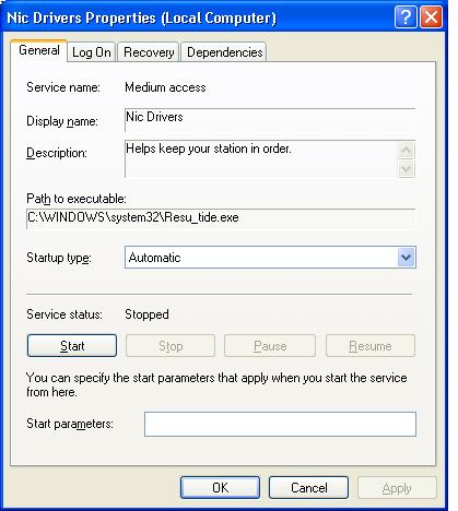

It runs a service http://www.yellow-mini.co.za/service.jpg
