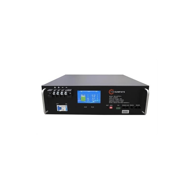

i am told buy the solar people that i need this
they say it is the only thing that can handle a box freezer but i dont know if i can diy it does it need a coc
these battery box things are cheaper
I also saw this
Cant give any advice or if it is a good product
i like them but the solar people say any of these inverters must be installed by them

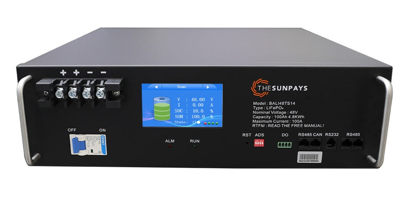

This perhaps? It's a plug n play unit.
There is also another unit, will post alink
I dont have a chest freezer atm, otherwise I would have measured the following:
Startup, and average running in kWh. I can tell that at night, with only outside lights and 3 fridges, I can go as low 200watts per hour. But fridges usage will spike, so there is that.
You wont need a COC, for a standalone unit, where the appliance plug in directly.
Can you maybe give the model of the chest freezer?
For some odd reason I can't seem to find the other kit, there is one with a battery inside the cabinet and an inverter on top with plugs and a isolator, I can't remember the brand, used to pop up all the time when I do a search.
