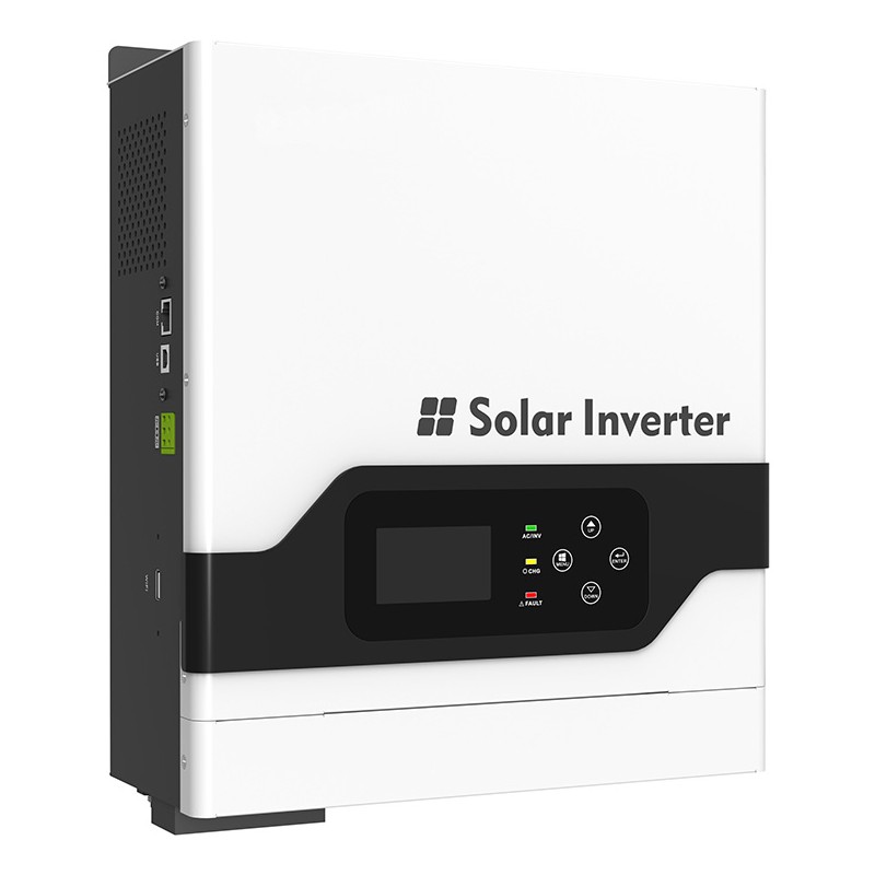

When My AC power goes off, my inverter states that my battery losses it's voltage and capacity within seconds.
I have checked my battery and even bought a new one. the inverter still says the same when AC is off.
I am only running my TV and my wifi router off the inverter.
Any advise in what the problem Might be and how to fix it?
It is a 1kw inverter with a 100ah Deep cycle gel battery.

Voltage will drop when you put load on it, that is normal. What you need to watch is the voltage doesn't go below the 50% voltage for LA batteries.
that is the thing, the voltage drops below 50% within seconds and the capacity runs from 100& to 0%.
I purchased a new battery after it happened the first time, and it is still doing that with the new battery.
Ok, what inverter is it, what TV are you running, is it 1 single 100ah battery?
Also generally gel batteries aren't really great for backup power solutions.
it is a 1KW inverter. I am running a Hisence 70 inch, and yes, only 1 single 100ah battery
Maybe the new battery is DOA? Have you got a multimeter to check actual battery voltage?
I do not have a multimeter no.
when I connect the battery to my father's inverter, everything works well.
that's why I think the problem is with the inverter?

Well I think we've found the issue, get a new inverter
