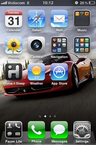

Need some help. I got a 3GS on 4.0.1, not jailbroken.
The other day my screen showed weird colours. Almost nagative, but not quite. The blues have turned purple and the yellows turn green. Everything else stays normal.
It sometimes goes away if you lock and unlock. I have checked, it is not the white on black setting in accesibility.
Has anyone ever heard of this before?
I figured an os update might flush it. So I updated to 4.0.2, but it still happens from time to time?
I'm concerned this may be a hardware issue...

Pic of when the colours are normal:
