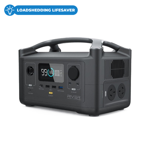

I'm not sure if this is the right place to ask this. I'm looking for something that can power a PC with a 650w power supply, a screen, modem and 1 lamp for 2 hours. Something like this, compact and mobile.
This the right thread?
Get a plug that will tell you how much power you use in the time that you want to run from batteries. This will also tell you the peak power requirement: https://www.geewiz.co.za/gadgets/43...10&sfdr_hash=105bbe2e1143851ca6a6836c4c2b3300
Those do look nice design wise and portability, however not sure about the specs. I don't like the only 500 battery cycles and how will you replace the battery? . Won't our current loadshedding kill it within 2 years. Would be nice to see an in depth review on these.

No problem, it's actually more general. See lots of adverts for it, I am surprised we haven't seen a thread and user based feedback yet. They do look nice on the outside and practical to move.
Would like to know:
- how well does it work for an always on UPS, compared to an inverter setup like an Axpert or Mecer
- how noisy is it. Mecer and Axpert type is loud.
- how long will the battery last and why only 500 cycles if it is lithium. I would think at minimum 2000 cycles
- what protection is there for the batteries cut off or is that why they say 500 cycles running them flat
- how easily can they be replaced and what are the costs
- how long can you run it at its full wattage etc.

fwiw I think 500 cycles is standard for certain types of Li chemistry. BUT that does mean full to empty or empty to full. So if, for example, you charge between 30% and 80%, that would only count as half a cycle.
