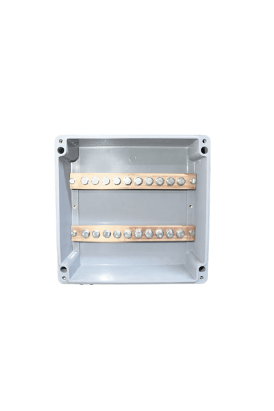

Get the Victron ones from Bluesolar. They are in Centurion/Pretoria. I actually bought 2 on Monday to replace the ones I have as they come with a cover etc.So hard to find a decent and affordable busbar. Any suggestions?
I was looking at this so far

Not bad. And completely sealed I see.![]()
Allbro 2x10-Hole Battery Busbar Box M8 600A
Allbro 2x10-Hole Battery Busbar Box M8 600Aeasypowershop.co.za
Looking for a better price but using this one
Seems like its the best price around. I paid like R800
Bluestore. Not blue solar. I must say it is way more expensive than @DTBA one. I just liked the Victron ones.Get the Victron ones from Bluesolar. They are in Centurion/Pretoria. I actually bought 2 on Monday to replace the ones I have as they come with a cover etc.
