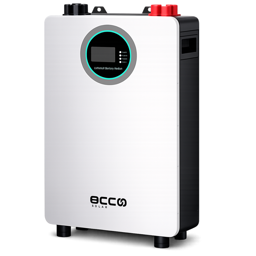

Well, 5000W divide 40V = 125A. 125A x 1.25 = 156.25AI was thinking 250 -300A max
300 would be nice future proofing.I was thinking 250 -300A max
Let him get the 300A. Always buy and design for the future. Not now.Well, 5000W divide 40V = 125A. 125A x 1.25 = 156.25A
I already have fusing. Just needed the busbars. Spent 550 rand for both in total.Um, this one is R2100:
and takes these:
How do you know LFP cut off is 46V? What if BMS goes faulty?
Anyway, 135A then vs 150A.
Yes.Don't you need to fuse each individual battery positive terminal?
Yes.
Yes. I dont know if BMS protection is enough. Always better to have mechanical protection.Don't you need to fuse each individual battery positive terminal?
What is the max safe discharge for your battery? Think they give it as 10 seconds or something like that. You don't want nuisance trips from the fuse.Recommendations please? 125A is the size recommended for 5.12kW batteries so looking for that or max 150A.
Fuses are to protect the cable, so the fuse goes before the cable melts.Recommendations please? 125A is the size recommended for 5.12kW batteries so looking for that or max 150A.
I would get one that matches the safe max discharge for the battery.
Oh you have breakers not fuses. Each 5kWh battery would be 100A plus 25% so 125A fuse. So if 2 batteries, then cable feeding inverter should have 250A fuse and 300A cable?What is the max safe discharge for your battery? Think they give it as 10 seconds or something like that. You don't want nuisance trips from the fuse.
