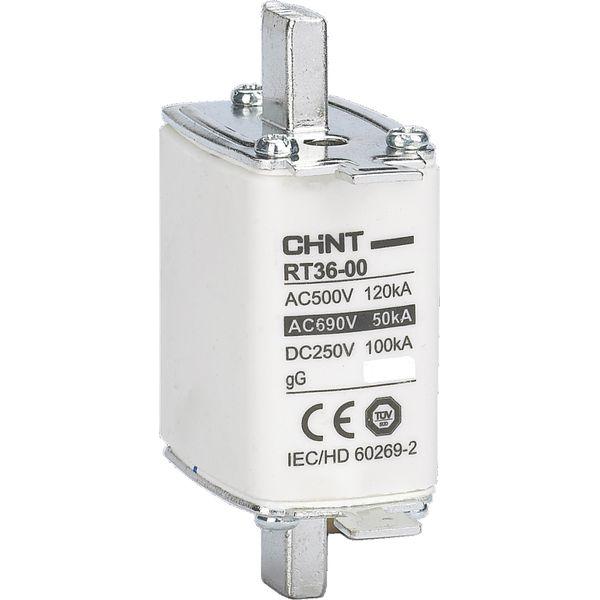

A fuse is just a piece of wire, really, that melts under enough current. I wonder what they meant when they said it doesn't have the rated capacity to break the current of a shorted battery?I am not going to be splitting hairs but when I looked at megafuses price (58v and higher) I went with normal T class fuse and disconnect. I was reading that mega fuses does not have the ratted capacity to break shorted lithium battery bank?
Probably that is doesnt break but welds together?A fuse is just a piece of wire, really, that melts under enough current. I wonder what they meant when they said it doesn't have the rated capacity to break the current of a shorted battery?
That terminology is typically used with breakers and isolators.
I am trying to think of it practically. The fuse is rated to break at any current higher than its rating.Probably that is doesnt break but welds together?
Should we be worried about cheap?
was reading thisI am trying to think of it practically. The fuse is rated to break at any current higher than its rating.
It also has a voltage rating at which it can safely break the current without a big energy release. If rated at 58V, for example or higher, under an internal short in one of the batteries, the voltage will get pulled down drastically, not go up.
So the voltage rating is met, and the current requirements are met.
Maybe I am missing something else.
Those are fine I would think. Its the housing that keeps these fuses that are of more interest.Should we be worried about cheap?
"This means that the MEGA fuse will blow, but the DC arc will continue jumping the gap and potentially start a fire."
@DTBAThose are fine I would think. Its the housing that keeps these fuses that are of more interest.
