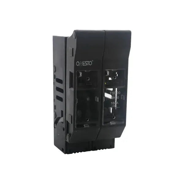

Fuse Holder 2 Pole 125-160 Amp NH00
160 Frame Size; Fuse Switch Disconnector2 Pole for 125-160A Fuses
I guess it makes sense.
You can have cheap housing and proper fuses. The one you linked is a good brand.They are good from what I can see so far![]()
160 Frame Size; Fuse Switch Disconnector2 Pole for 125-160A Fusesbritelighting.co.za
Like i said it was not much more expensive for me to do it this way, I also get a battery disconnect per battery that I wanted.I guess it makes sense.

Go with @DTBA method. Allows for individual battery disconnecting, even under load.You guys are confusing me. So how do you fuse 3 x 5.12kW batteries in parallel?
I have a 160A battery disconnect before the inverter but now that is not good enough because I have 2 x batteries and want a 3rd.
This means I need to fuse each battery. Do I install another battery disconnect fuse holder and just get 3 x 125A Chint fuses?

How do you connect the 3 disconnects to the inverter?Go with @DTBA method. Allows for individual battery disconnecting, even under load.
MEGA and your current disconnect switch only allows the whole bank to be disconnected but not the individual batteries.
I like his method better.
