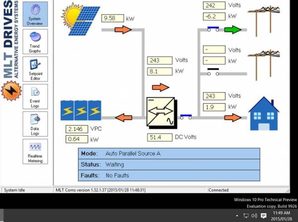

Here's a screenshot from a few minutes ago, showing 9.58kW solar pv being generated, with just over 6kW being exported to the grid.
To answer P924: Yes, my model is a hybrid and has built-in charge controller. However, I also have three Outback MPPTs as I have three separate arrays (totalling 12kW). The system is intelligent and manages everything seamlessly - grid, 2nd AC source (eg generator), solar pv, batteries. The MODBUS is connected to the LAN/internet via a Raspberry Pi, so I can access it from anywhere.

Thats quite impressive!
