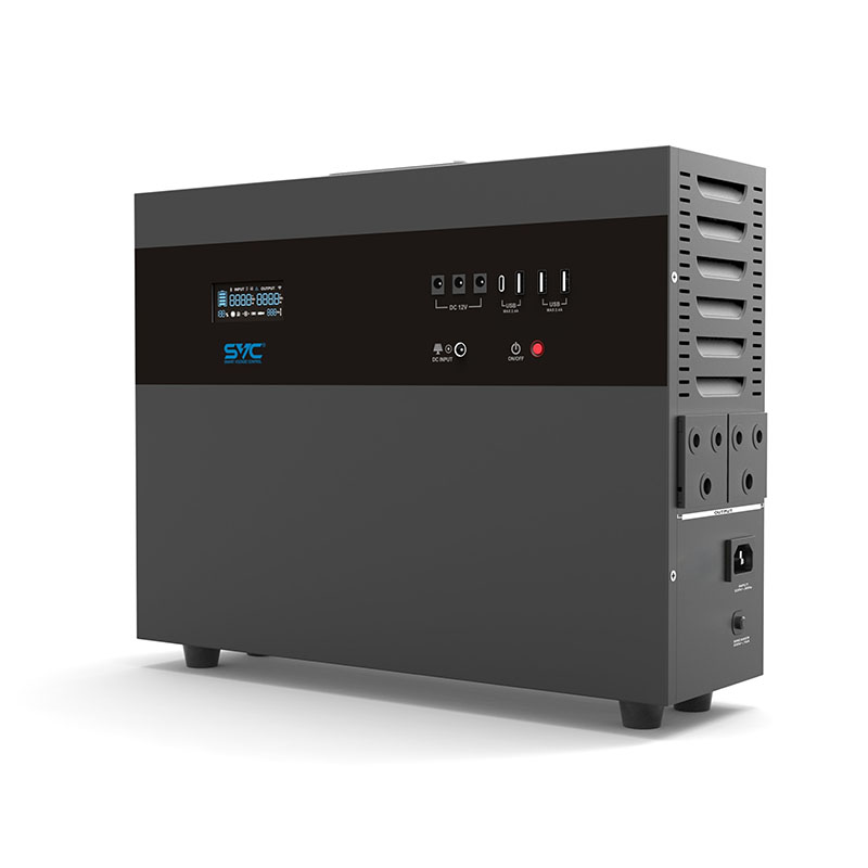

Seems a good price if it does in fact include the batteries.
Seems to be this model, which does state it has LifePO4 batteries, just wish Geewiz gave more info.
On Geewiz it says it charges at 20a on the second site it says 10a. I wonder how long it takes to charge.
