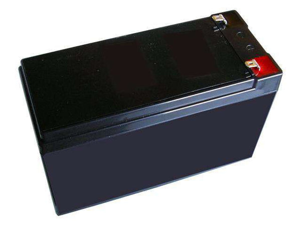

You can make your own PSU with one of each of these:
~3 Hrs @25W. You can add more batteries as needed
I will make one up for you at cost + R200 if you want
