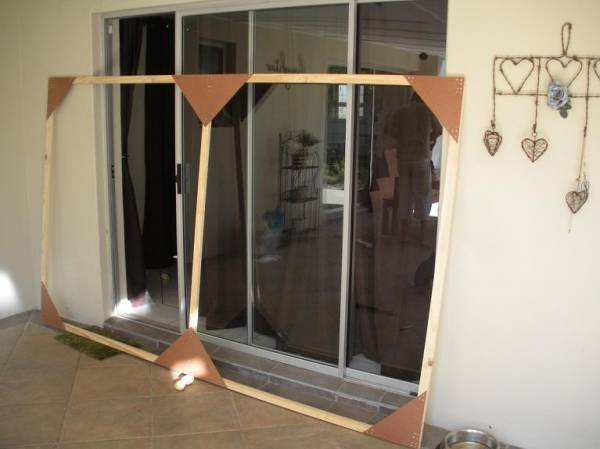

Yesterday I finally got round to assembling the frame - the screen itself will be 2.70m x 1.52m (diagonal 3.1m) - I've added 11cm on the four sides of the frame for black border tape*. Giving me a frame dimension of 2.92m x 1.74m. I'll post a picture of the frame later today.
I still have to figure out how to mount the frame so its easily removable - and attach the screen material - hopefully by next weekend I'll be done with watching movies on an oak coloured wall.

Here's the frame
Nice. Have you got one with the cloth over it as well?
What did all the parts set you back in cost and time?
Haven't done the cloth yet - its on my to-do list for this week.... I first want to decide on how I'm going to mount it before putting the cloth on (don't want to risk damaging it, as its high end and expensive to replace).
The actual frame was cheap - think it was around this:
* 2x 3m planks @ R35 each = R70
* 3x 2m planks @ R27.50 each = R55
* 1.5m x 1.5m board @ R60 = R60
* 92 screws @ R60 a bag = R60
R245 for the frame.
I'm sure mounting it won't be more than R100
Then R330 for the black tape.
Screen material (depending on what you use) can be anything from R240 (3m of blackout curtain) to thousands
So you can build a professional looking screen for around R1,000, with the black tape being the most expensive - still not sure if its worth it, but I'll report back when it gets here - might just be the same as black velvet material.
