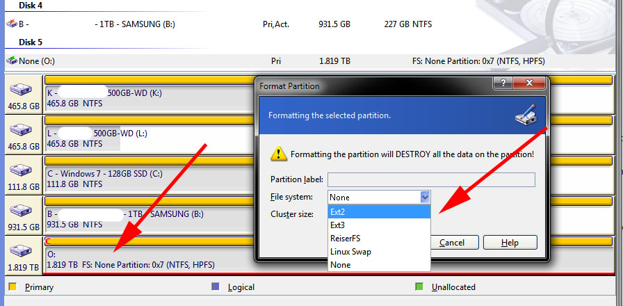

Herewith an update, and I'm now even more confused....
Went the long way round and backed up all the files, then on a test 2TB HDD deleted the partition and installed it into the Seagate USB3 external case. On plugging in the USB cable and powering on, it asked to format the disk - I said "no" and was going to use Acronis Disk Director to create a partition and format as NTFS accordingly (all my HDD's are NTFS).
Now the interesting part
- Acronis picked up the now external drive, but would not give an option to format as NTFS - the only options were: Ext2, Ext3, ReiserFS, Linux Swap and None - no NTFS... now I don't know (and have never used) any of these formats; only ever used FAT, FAT32 and NTFS.
- So I popped the HDD back into the PC via direct SATA connection and created a single MBR primary partition formatted as NTFS. Popped the drive back into the external case and got the same "must format" error when plugging it in - I have to format the drive... WTF
- Gave up as it was getting late.
- Just had a few hours spare now and powered up the external again to see what else I can try - voila, the external that was connected, formatted as NTFS (via the PC the previous day) and is now reflecting, i.e. it did not prompt to format, however it does not show the drive name and shows the following: FS: None Partition 0x7 (NTFS, HPFS) - what format is this?
Windows Computer management however sees the drive as a normal healthy NTFS partition with the drive name and all things normal... the options for file system formatting in Win CM are NTFS and exFAT only.
