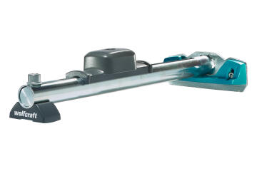

Wow, this thing makes life so much easier. I usually use just a hammer and the little pull bar, but this thing frees up a hand to help guide the board in.
Definitely recommend if you have a lot of laminate/vinyl planks to install.
Not a single edge damaged yet either from using it, and it distributes the force over a wider area than the normal pull bar/hammer setup.
Only downside is that it needs a bit of space on the edge pieces against the wall to fit in. If you have very narrow skirtings the space between board and wall may be too big.
But you should be leaving space for expansion between the walls and the planks anyway, so looks this thing will fit in perfectly in the gap you are supposed to leave to allow for expansion.. at least for laminate flooring.. have not done vinyl yet, so don't know if vinyl needs expansion gaps..
Also, I would redo skirtings anyway, of I lay down vinyl/laminate flooring.. would make for a much neater finish..
SAguy
Nov 4, 2013
10,614
Vinyl planks are installed the same way as laminate planks, so gap is also required.
Yeah, it does fit in the expansion gap but I found that the expansion gap is just a touch bigger than I would normally make it. I would still recommend having a pull bar available for those tight spots around doors and so on.
