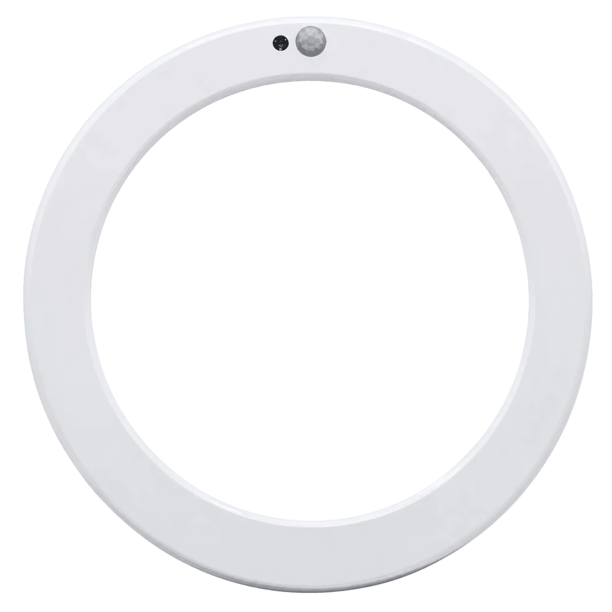

Anybody know where I can buy this type of light at a brick & mortar store in Pretoria today?
Want to install it in the hallway and I have the time to do it this weekend.
