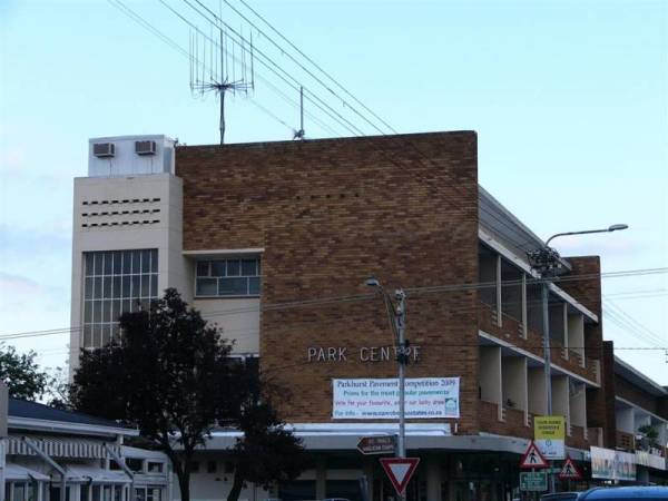

So, the Craigavon station is what - 20m or so up? (I forget exact number now) - here are two *significantly* lower down stations in Linden and Parkhurst that have been there for YEARS with nary a peep from anyone in the surrounding areas about untoward effects ..and note how the Parkhurst one is on some poor oke's ROOF!
Poor oke, get's a second pay check every month... I really pity him... hey Jannie, come stick one on my roof... I'm Jewish, so I'll give you half price... :D

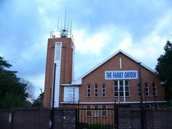

Maybe the Linden and Parkhurst towers havent yet had the iBurst technology added to them yet?
You mean the respective iBurst towers I presume? :p :D
..ok, sorry; I couldn't resist. Those are two iBurst base stations/towers that have been around for yonks. And there are plenty others - the one on top of a small shopping centre roof in River Club comes to mind (but MAN you should see the signal level I get off that thing!)
