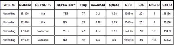

Hi guys,
Here are the results - with Cell ID with MDMA
Speedtest was done on speedtest.net - but without the booster, Vodacom is DEAD and I won't connect. It's also not an antenna as nothing connects to phones, iPads etc - so it i a booster/repeater item

What does LAC stand for?
Starting to look like an overloaded tower more and more given how the ping is quite good (I'm assuming you did several tests and averaged them) while the throughput suffers.
I copied lack from MDMA ... I have no clue what it means ;)
Yea - it's actually been around those figures since I moved in 7 months back. So at least it's consistent - and I understand they're busy erecting another high site in the area due for a few months time
