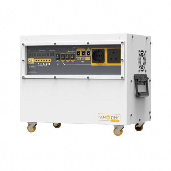

That doesn't look great. With a 10a charger that thing will probably take more than 8 hours to fully charge.
