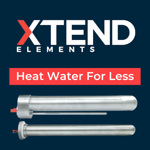

Hey guys so the geyser is a non issue summer - I have evac tubes (on a geyserwise) they fine for the evening in winter but the morning its cooled down substantially overnight. With new solar system installed the 3kw element will work but this appears to be a better option anyone use them? I am aware heatpumps are an option but was considering just running this for 30min in the morning for the extra temp bump.

How does it save energy?
Has anyone used these elements? The manufacturer makes some pretty bold effeciency claims which I'm drawn to, but sceptical about. I'd be very interested in some independent opinions.

You really can't be much more efficient than a heating element submerged in water. Even if it wasn't efficient the energy "losses" would be heat?!
So, this is just a smaller element than normal - i.e. lower power. It will use less units in an hour, but it will also heat your water less. So the same as switching off your geyser more... The ceramic-ness just means it won't corrode like a metal element (maybe fail in some other way... Cracking maybe?)...
There really is nothing to see here.
Edit: just read the full thing... Okay if you have very hard water, there may be something to this. If you have bad problems with lime-scale buildup in your geyser.

That is what my science brain tells me too. Their published tests tell a different story though. They reckon they can heat the same amount of water to the same temp with a lot less power.

Through all the marketing blurb, I cannot with certainty distil whether they are referring to a 'saving' in instantaneous power draw vs total energy used to heat water, without fiddling with settings / making sacrifices.

They're definitely saying it uses less energy to heat the same amount of water to the same temperature.
CONCLUSIONS
31% more energy is required by a 3kW Standard Spiral element to achieve the same heating results as the Xtend 2kW PTC element.
34% more energy is required by a 2kW Standard Spiral element to achieve the same heating results as the Xtend 2kW PTC element.
It takes the same amount of time to heat the water when comparing a 3kW standard spiral element and an Xtend 2kW PTC element.
