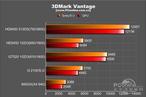

- The GT520 kicks the ati 5450 in the ass
- nVidia is better for XBMC
Yes they might have a "fix" for the ati cards, but the gt520 is better anyway, isn't it?
Is it a Mega Gaming PC, or a HTPC? Lol.
The HD5450 is the best suited card for the HP MS as a HTPC due to it having the lowest power usage (load and idle). Remember, you are not adding your own beefy power supply, you are using the built-in PSU which is very small.
The HD6450 (also silent) has about twice the amount of stream processors, and also works. Uses more power though. Again, unnecessary for a HTPC.

Incorrect. But anyway :p
Keeper
Mar 29, 2008
23,624
Not sure that has anything related to what most peoples goal of buying this server is. ;).
Both play 1080p content fine. The ATI cards just does it while being quieter and using less power.
I just posted the benchies as you said i'm incorrect about the Gt520 being a faster card.
surely that card doesn't make THAT much of a noise though?
