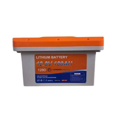

I have a suspicion the fridge gets very close to the max 100A at startup, not very efficient so there is a slight dimming of lights when it kicks in, with the TVs and lights, the 200Ah is the comfortable choice.
Yes, but it takes a few seconds to trip a bms so it should be over before it even cares. I've seen people start cars with 100Ah.
The BMS is the issue, not the actual battery.... if the 200A battery has the same BMS in as the 100A battery then you will have the same problem. The BMS is what limits the AMP draw, the battery size has nothing to do with it. Usually a bigger battery should have a bigger/better BMS in to handle more amp draw, but you need to confirm that with the supplier.
I challenge you to find a 100A bms that cuts out from overcurrent in 0.3 seconds.
I challenge you to find a bms that cuts out from overcurrent in 0.3 seconds.
WTF has that to do with typed?
I have seen an el cheapo 200A battery that had a max draw of 80A due to the BMS it had. I don''t give a F what it trips out on, just informing one has to make sure if is says 200A on the battery also make sure the BMS can do 200A, that's all.
You don't think the 80A bms can start a fridge?
To add I am looking at better brands so that I am able to add on, need it for a small system for fridge, lights and TV.

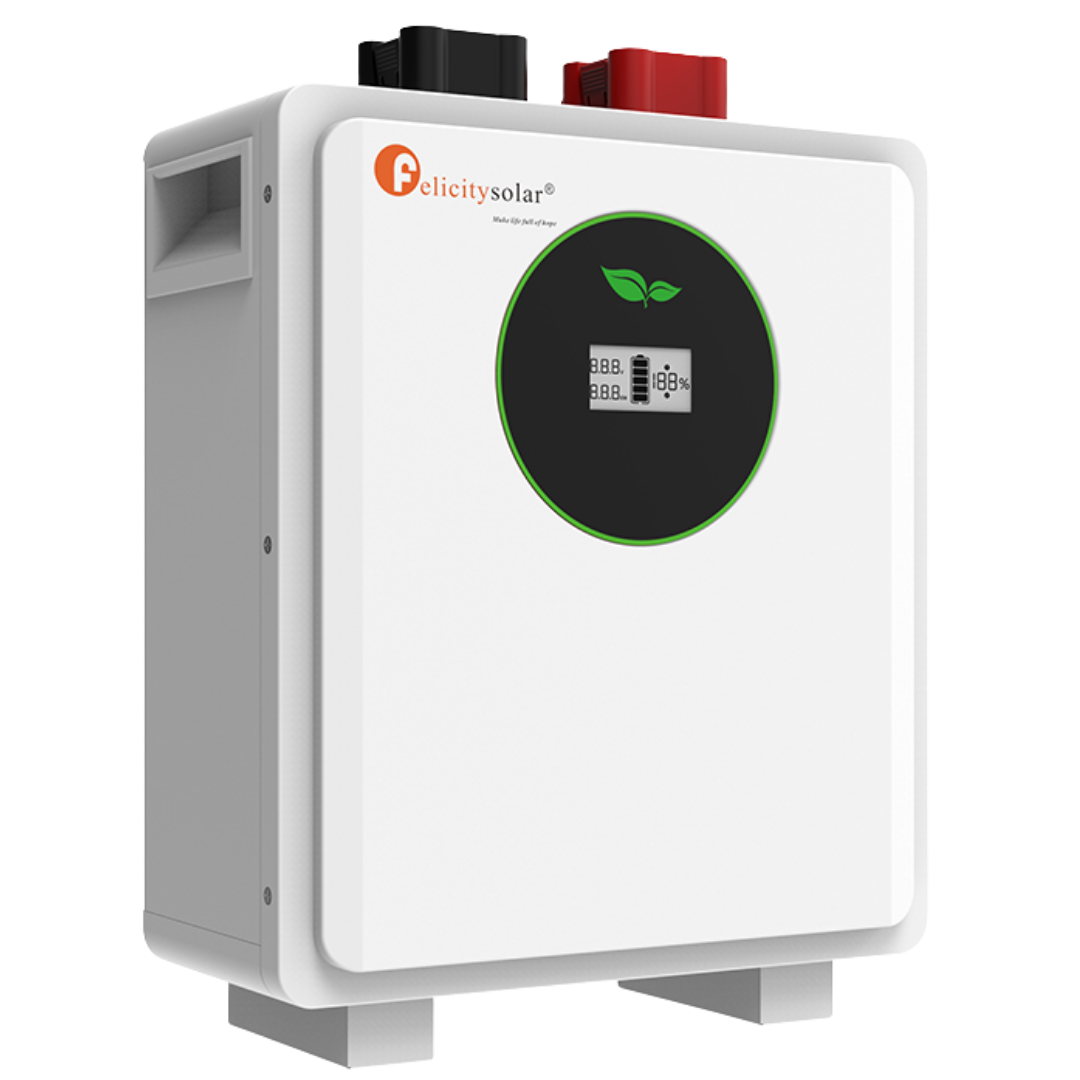

Ended up dumping the 12V system for a 24V system, well not dumped since the 12V will continue doing its duty, mainly on lights, but upgrading it was proving challenging, it had a nice 2000W inverter but with an external mppt that was limiting on solar.
Got this, will be paired to 3.6kW Luxpower and three 460W panels, for now. Running at a lower current will also not hurt.
2000W on 12V?
What's the start-up voltage on the luxpower?
2000W on 12V?
Yes, it was a thing back in the day, it's a beast of a thing with a massive transformer, that weighs a ton. TBB, absolutely indestructible. Wasn't drawing anything close to that but it was nice for surge current appliances.
66V
66V
2000W is like 160A. You're probably limited to 100A on 12V 100Ah LFP before bms cuts out. Are you using 75mm² cable?
As i say, I wasn't using anything close to its maximum power, it had lights, 2 TVs and the fridge, regular running current would be less than 500W.
I first started with a 600W that promised double that for surge current, which turned out to be a lie, so this was a safe bet.
