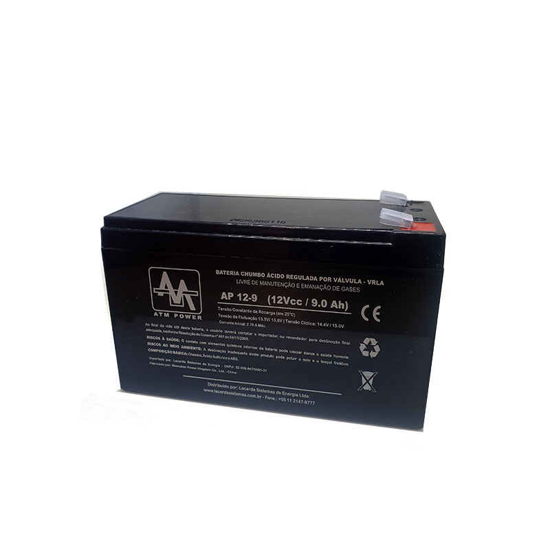

Seems its different sizes (garage door ones being physically smaller)? It should work, if there is space to fit it.
768190
So the "recharger" found on the garage motor, will it be able to charge a bigger battery as per your pic you posted?
It should. It will just take longer to charge if discharged far, but then again, it will take longer to discharge to the same %, as long as it's all lead acid batteries.

To circumvent the high prices of the 24 V batteries for the garage door motors I just take two 12V 7/8/9Ah ones and tape them together with Duct Tape. The DC Blue batteries are on the rail, outside the motor, anyway.
I get the two 12v8Ah batteries at almost half the price of the 24V dedicated version.
