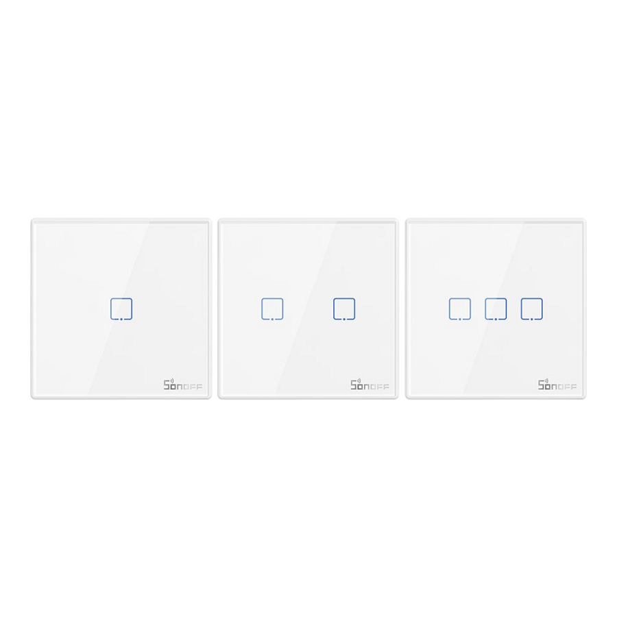

I'm leaning on le grand with shelly relays to replace the veti that I currently have. Vetis are really poor quality wise switches plastic have actually cracked.
I like the le grand as it looks good, the sonoffs just look fugly.
Also with the dumb switches if the shelly blows then it's easy to replace with a new relay rather than matching a new switch as they might be discontinued.

No certified option for 3 way switches. Unless I use a Shelly relay. But then doubt the physical switch will operate as a 3 way switch? Not sure.

2 way? - I assume you mean the 3 way switches or 2 gangs?
3 gangs as in 3 switches in a box with a 2 way (controlled from 2 different locations)
A 2 way switch only need 1 Shelly relay. You put it on only 1 of the 2 switches and the the 2 switches go on the Shelly as if it is one switch. The just route to the Shelly instead of the lights. Easy as pie. I have it like that on mine.

Also dumb switch plus shelly works out to more than double the cost of using sonoff switches

Advantage is Shellys SABS certified.

Can I replace my treatlife 3 way smart switch with dumb switch and shelly relay?
I've said it before, but I'll say it again :
I much prefer a tactile switch over a touch sensitive design. The Sonoff touch switches are not great - the touch design is impractical and they actually don't look great on the wall, unless you fabricate your own housing.
I'd much rather go a relay + traditional light switch
