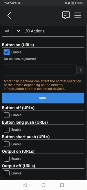

For local , go to I/O settings and read up about direct device to device (DDD) communication
