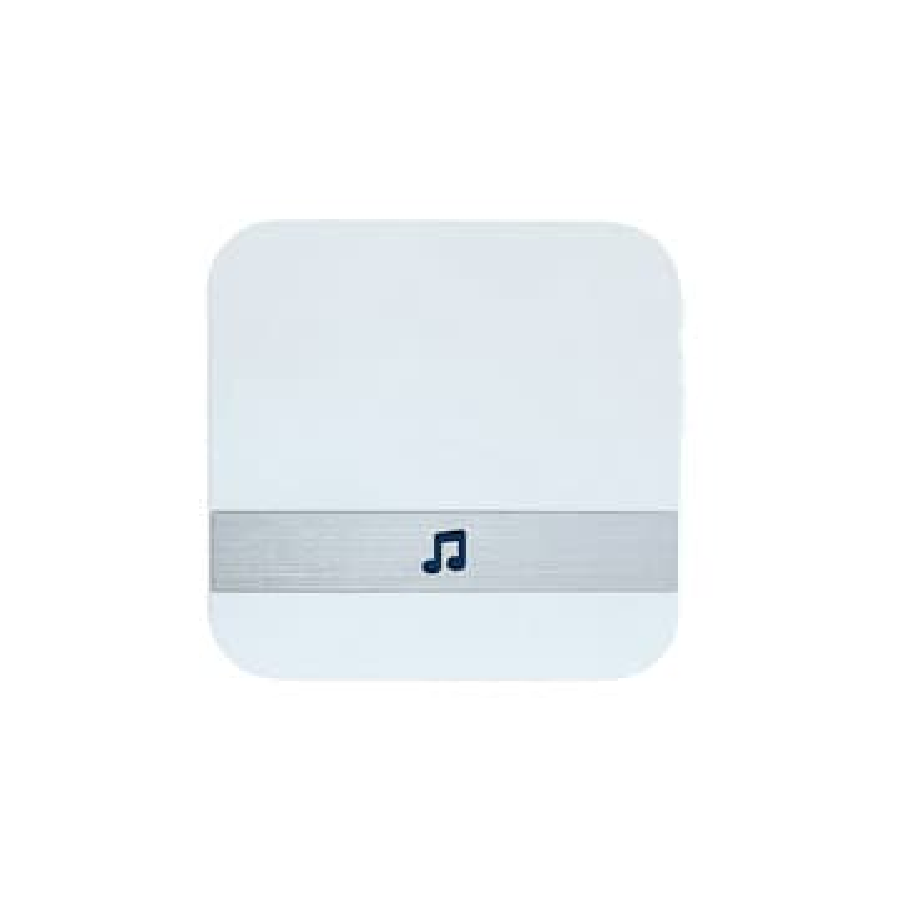

Guys, I need a cheap smart idea for a door bell. Doesn't have to ring, camera or anything, but I'm looking for a solution, where I can place some outdoor switch, which can then alert me on my phone or Nest hub that somebody is at the door.. don't really want to spend money on a nest door bell, as I have cameras outside already.
Is there something like this out there, or ways one could implement something like this?
You can either use a Shelly smart button (battery operated version). Or Aqara etc.
OR
With a
Could link via Home Assistant to the phone or speaker etc.
