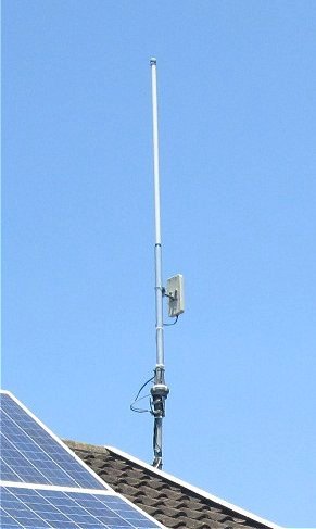

Well now that I know a bit about roaming (thanks guys) everything here is falling into place.
I am on Telkom prepaid LTE and their tower is about 2 km away.
This made me get a Poynting Xpol-6-10M antenna to get a better signal which I mounted temporally outside.
My signal here is -80 dBm and my download speed is around 85 Mbps most the time.
On the 8th January I set out to permanently mount the antenna on the roof.
While setting it up I found that I could now get a signal from the Vodacom Tower of -70 dBm which totally baffled me and I thought Telkom had put LTE on this tower.
Btw, all tests were done on 2300 Mhz - Band 40, mode 4G only on a B315 router.
After testing on this new place I was only able to get 52 Mbps which I found a bit odd.
So I found an old rotator in the garage and put that up there, now I can turn the antenna between the 2 towers.
Oh, btw, roaming is switched off on the router.
Edit ***
Just testing now in that if you move the antenna 20 degrees past the Vodacom tower, although the signal drops, the SINR increases to 30 and the downloads increase to 80 odd Mbps

Where are you located - more or less - no need to be specific if you dont feel comfortable ? Then it's very strange that you would pick up the Telkom roaming on 2300MHZ as Vodacom do not have spectrum. Could it be that telkom also have capacity on the second tower?
I'm in Hilton - KZN.
Yes the frequency also struck me as odd but thats where it is.
I tried the Vodacom frequency of 2100 Mhz but that's dead.
If I switch to Band 3 - 1800 Mhz then I get a signal from anywhere I like :)
Before it only worked when pointing directly at Telkom.
Band 38 - 2600 Mhz, Toolbox or LTEWatch cannot do, although LTE_Band_Tool_v0.1 can do it I have not tried.
Also waiting to see telkom signal popping up.

@ProAsm Can you post a guide on the forum how you set up the rotator :cool: please? That is pretty smart. :love:
Wonder how you would be able to tell on an iphone if its telkom or vodacom
I just used an old TV Rotator, but I got it about 30 years ago when we used to swing our TV aerial around to different SABC towers :)
They are very simple to install and go in series with the mast you bracket to the wall.
The one I used is a bit big, if you can find a smaller one go for it.
I've seen some Radio Hams use old windscreen wiper motors as well and works pretty good.
Here is one identical to mine.
https://www.gumtree.com/p/antennas/yamato-antenna-rotator/1209591190
https://www.ebay.ie/itm/Yamoto-YS-130-antenna-rotator-with-controller-cable-see-video-/152895473748
