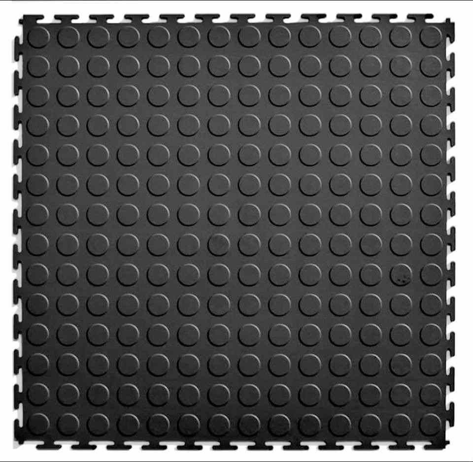

Also I've got a fair ton of this in the garage (for 5x5m) - but I suspect due to it being PVC (as opposed to rubber) that it would a) be too hard and b) because of the bumps (pattern) that it wouldn't work well.
