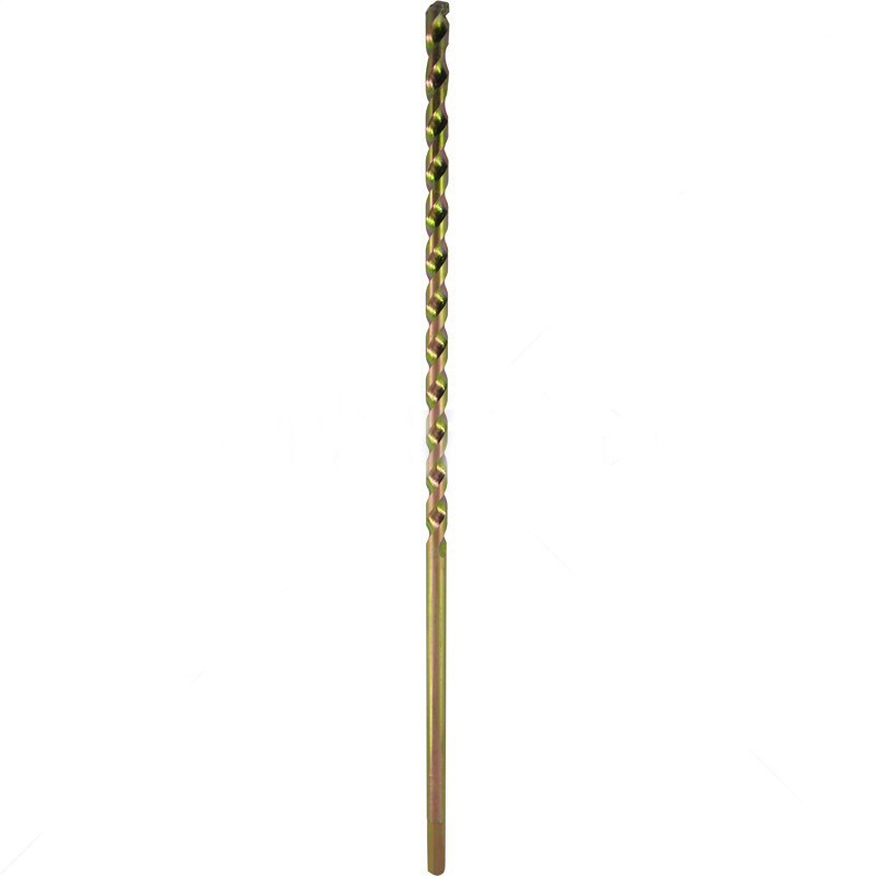

I need a decent drill bit for my cordless drill.
I want to drill through walls to run my ethernet cable through it. It must be a bit bigger than the diameter of the ethernet cable, so that I can add a sheath into the wall as well.
I was looking at some drill bits at builders and they are approximately R400.
Anyone know of a decent brand drill bit?
Normal drill or SDS?
If it's cordless with no hammer function, you'll be there all day. Your local Gelmar should have - get a long one if possible, so that you can reach through double walls if your run necessitates it:
Something like this^^
Or this:
Through a wall with a cordless? Eina. That's gonna take some time and possibly ruin your cordless drill.
See if you don't have a mate with an SDS drill, that's gonna work much better and go through a wall in no time.
Yeah it has a hammer function.
DeWalt DCD999
DeWalt DCD999
Don't ruin your cordless like that.. yes, it has a hammer function but, not made for drilling through walls and it sounds like you are going to be drilling through a few of them..
Corded drill, higher wattage, 650W plus will be your best friend here..
If you want a quality bit, can't go wrong with alpen and this will be long enough to go through double brick walls..
You really want a rotary hammer drill and an SDS bit. I have a 1900 watt Makita, it can take 20mm bits and have drilled through granite
It goes through a wall like a knife through butter (with a 8mm bit)
My local Chinese shop sells SDS bits, a 12mm and 400mm long is R60,00. Had it several years
