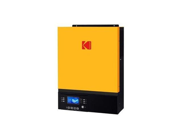

Got a few units of the below unit in stock with me here. Can supply you the battery cable if you need that also.
Have not had trouble with these units and they are quiet. Have been using them to build inverter trolleys. Yes they can be placed flat and not mounted to a wall. Do you have a battery box already?

I have this one, yes can be flat. Connected to two Hubbles.

Looks good (looks the same as the Kodak with bottom left display) but that unit is a bit pricey compared to others, R4000 more...

I do have a cheaper version available also going for R7500 and still has a MPPT controller but doesn't have a removable display. I like the removable display on the RCT version, just add a longer cable and the screen can be mounted where ever.
