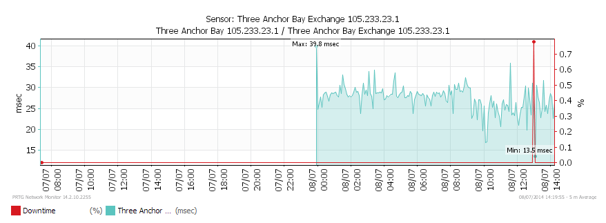

Here's the data for your exchange:
Your exchange is not looking too healthy to be honest - there was downtime and there are some very unusual spikes, as well as a high baseline measurement. In addition, while connected to our trial accounts we picked up on multiple port errors on your connection.

Thanks v much for this. Would it be possible to monitor this tonight for that 5pm-9pm period? This morning has been relatively trouble free, but always seems to hit hard at night.
This is whats been going on today, very tiny packet losses here and there compard to previous nights, but still not loking healthy to me

Since Telkom changed my port this afternoon (12:15-12:30 on the graph), everything has been really good! No extended or major packet loss at all. So the issue seems to have been definitely related to the exchange. Here's the graph for today:
I'm continuing to monitor, but looking good. Finally! Fingers crossed my line issues are solved, so I wanted to send my gratitude out again to everyone who assisted on this thread, especially Crystal Web and TelkomZA who I've been communicating with directly. You guys have really been amazing thank you
That is actually quite bad, 122ms on 1st hop indicates exchange congestion.
I see very brief spikes at the 1:35pm and 8:10pm mark, but the rest looks pretty normal? Let me know if I'm missing something
Nothing to be concerned about really - they're occasional spikes. You appear to have a far more solid connection now. Great news!
