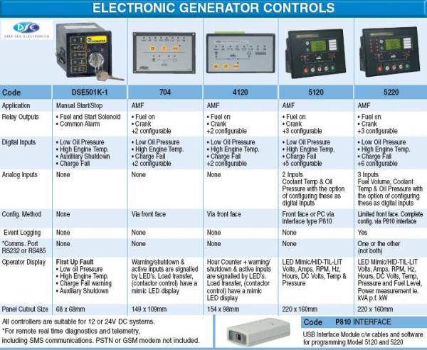

With this, will the generator start automatically when i have a power cut?
