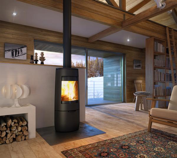

I'm only going to be burning wood. Speaking with both Home Fires and Fireplace Warehouse, the guys tell me that our anthracite is so dirty it's actually damaging the fireplaces and that going forwards they're not importing the multifuel models when there's a wood version available.Have you thought about the fuel you will be burning? I know up-country anthracite is popular even though you guys don't struggle with wet wood as we do in winter here in the Cape. I use eco-logs as it's always dry, manufactured in my town and burns to a clean fine ash making it easy to clean. Heat is also better than anthracite (or the crap quality we get by us).
I scope out the ash before each fire as I've an ashtray that catches most of the ash.I'm only going to be burning wood. Speaking with both Home Fires and Fireplace Warehouse, the guys tell me that our anthracite is so dirty it's actually damaging the fireplaces and that going forwards they're not importing the multifuel models when there's a wood version available.
How often do you clean out the ash from your fireplace? I ask because the Dovre wood burning model has this weird grid design that looks like an ice-tray - basically you need an ash vac to clean it out properly. The multi fuel model apparently has a more traditional grid design with a normal grid and a little lever on the side to agitate the grid (a much better design imo).
