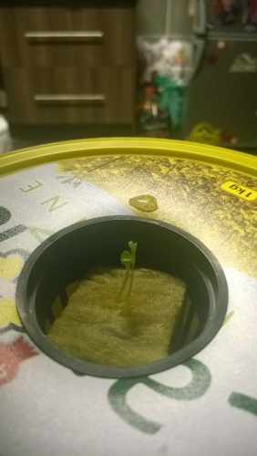

A week after "planting" the seed I transplanted into it's permanent home.

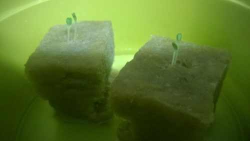

Germinated in rockwool.

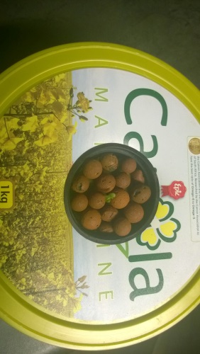

Into the net pot
Into the net pot

I could only get hold of the bigger block of rockwool, so had to cut it up to smaller blocks. They say plant atleast two seeds in each as they might not germinate which I did. Both seeds in both rockwool cubes germinated, so I have had total success. I readd the beginning of the thread on your experiences with rock wool. I think you had a bad batch or maybe a different brand?
Different brand. Complete and utter crap. Grodan is the only way to go for rockwool. That said I have grown a lot of seedlings in rockwool which worked fine but I definitely prefer the peat pellets now.

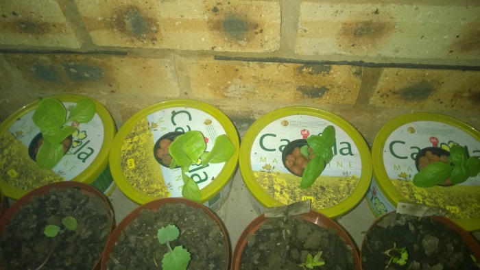

Just a quick recap for those who are interested. The lettuce I planted using the Seagro nutrient eventually wilted and died. This was in the heat wave that we experienced but I had a couple growing in the Nutrifeed solution at the same time and they survived (see image below). I don't think that the Seagro is suitable for Hydroponics unless someone else can prove me wrong but for now I will stick to the tried and tested Nutrifeed.
My tom thumb Lettuce and basil
